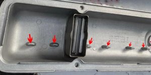

As part of a bling-up of my under-bonnet area I recently replaced the stock valve covers with a pair of LT1 cast aluminium items.
As well as looking pretty, these incorporate oil drippers not present on the stock covers.
The purpose of these is to drip oil back onto the rocker arm – and by default to the valve stem I guess – to improve lubrication. Not necessary but perhaps nice to have – unless maybe you have leaking valve stem seals?
