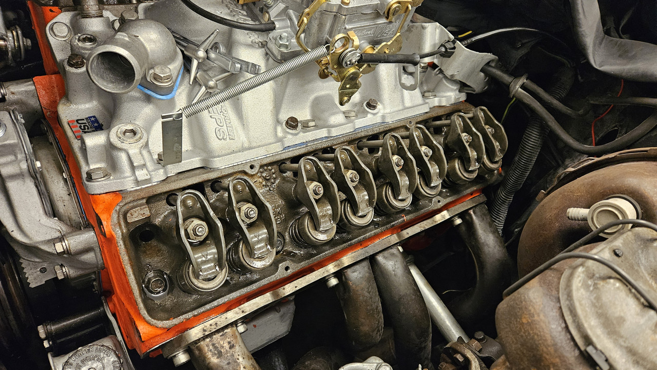

Are the three threaded holes tapped in to the water gallery of the inlet manifold? - If so (and it will vary according to car application) one could be for temperature sensor - another could be connection to by-pass hose in top of water pump (if actually used) - the third one a 'spare'?
yes all three are into the water gallery.
So i can blank them all off. just need the far left one for the heater core. I already have a temp sender. dont need a temp sensor.

Just a few small bits at first to warm up. Fitted the bungs to the outlets in the inlet manifold that i dont need. And then polished what i could be bothered to polish on the headers and exhaust. i know i should of painted the bolt heads first and cleaned back the liquid PTFE on the Allen screws.

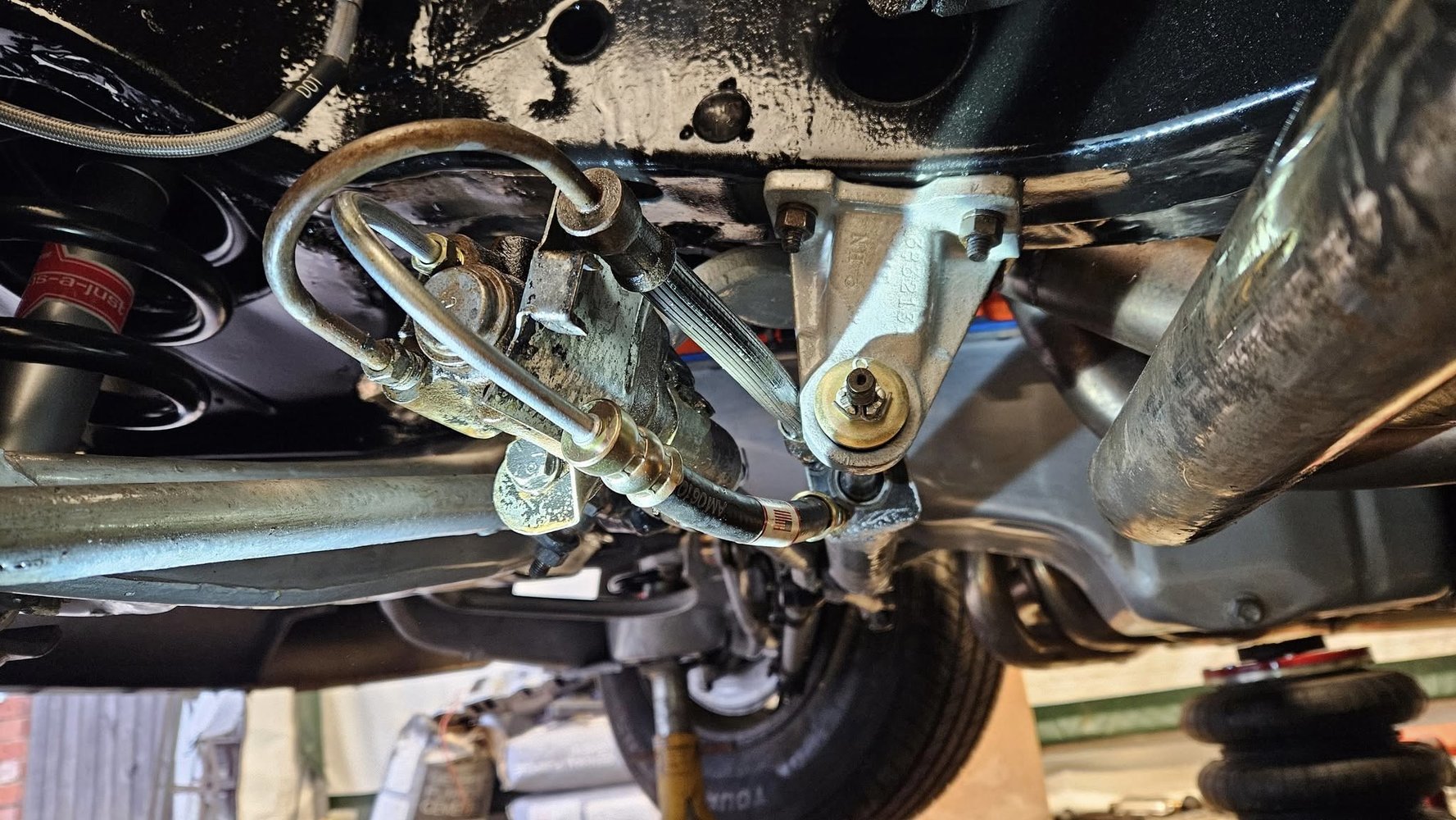

All thats got done is the other exhaust fitted. still need to sort the hanger bungs though. The Sway bar / ARB and i thought as i painted the fan ill see how it looks.
I was trying to find one of the ARB bolts but then i remembered one had stripped and was bolted through. Only after searching all over for it.
I only needed the power a steering lines from the pump to rack but as i got a full kit at a good price i fitted the lot. mite aswell while i am here. I have been saying that all along, the reason i have done all this. Oh While i am here. lol
And as its near time to run it in and not wanting to put the blame on anybody else when it goes boom and blows a piston i made this up so i am in control myself.
