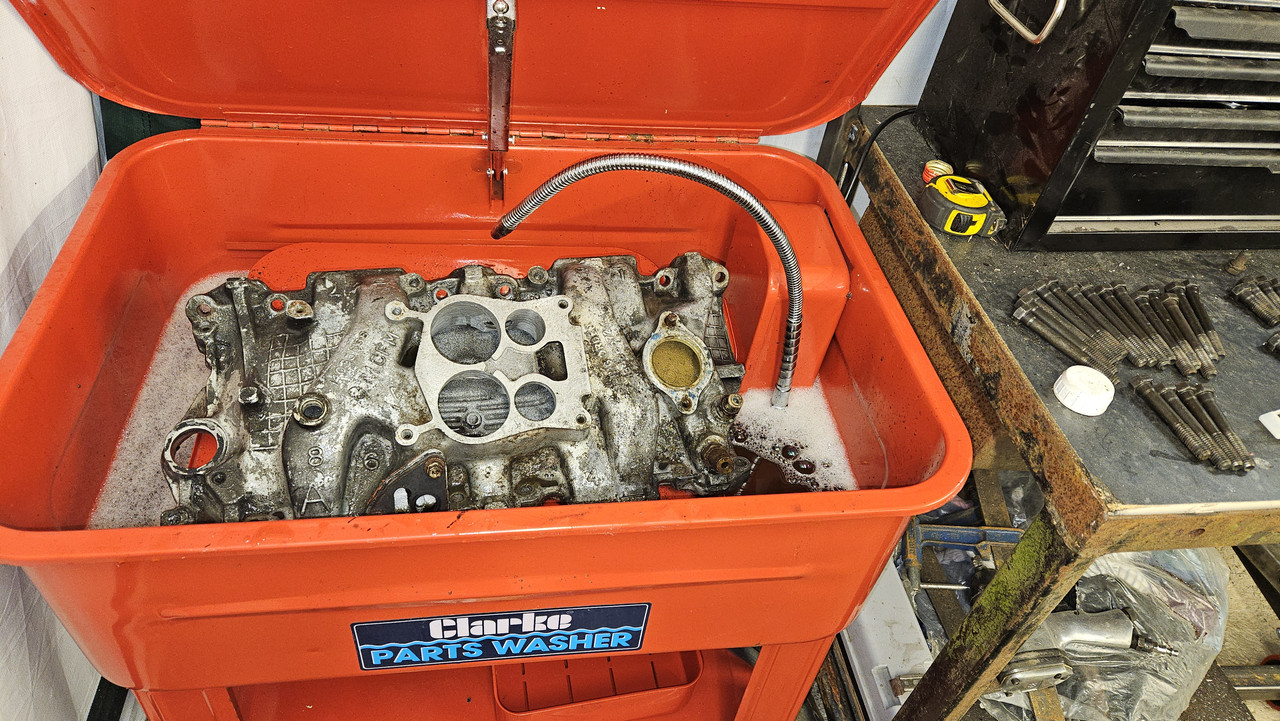

Manifold is in the cleaner as it was manky. Ill stick it in the sand blaster aswell to get it better.
I was sck of using buckets of degreaser so thought to just buy a parts cleaner. So thats soaking now until tomorrow.

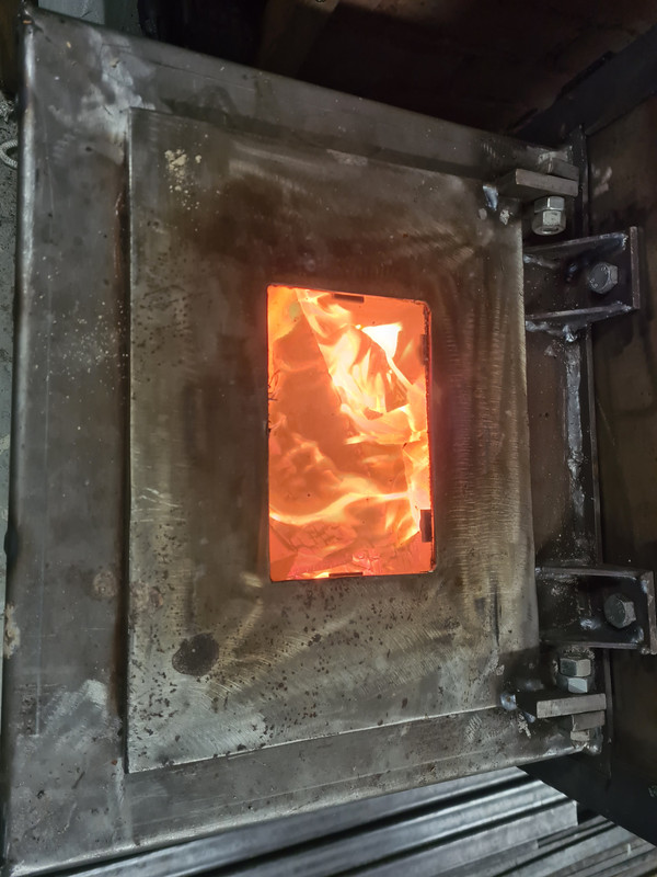

Love my tools and junk haha. It all keeps me busy. The stove is like a Mass air heater. I buitl it as had a diesle heater and was rubbish and i can get wood free from work.
Some pics of it when i built it.
Mina fire box
Then to the riser, when made correct you get a vortex and with a second burn it burns the gasses and give even more heat off.. And smoke free :)
Need to be carfefull as temps in there can get to 1200 deg C. this doesnt as not mad eit to do that, to warm as it is at times. Vest and boxers in midwinter at times haha
