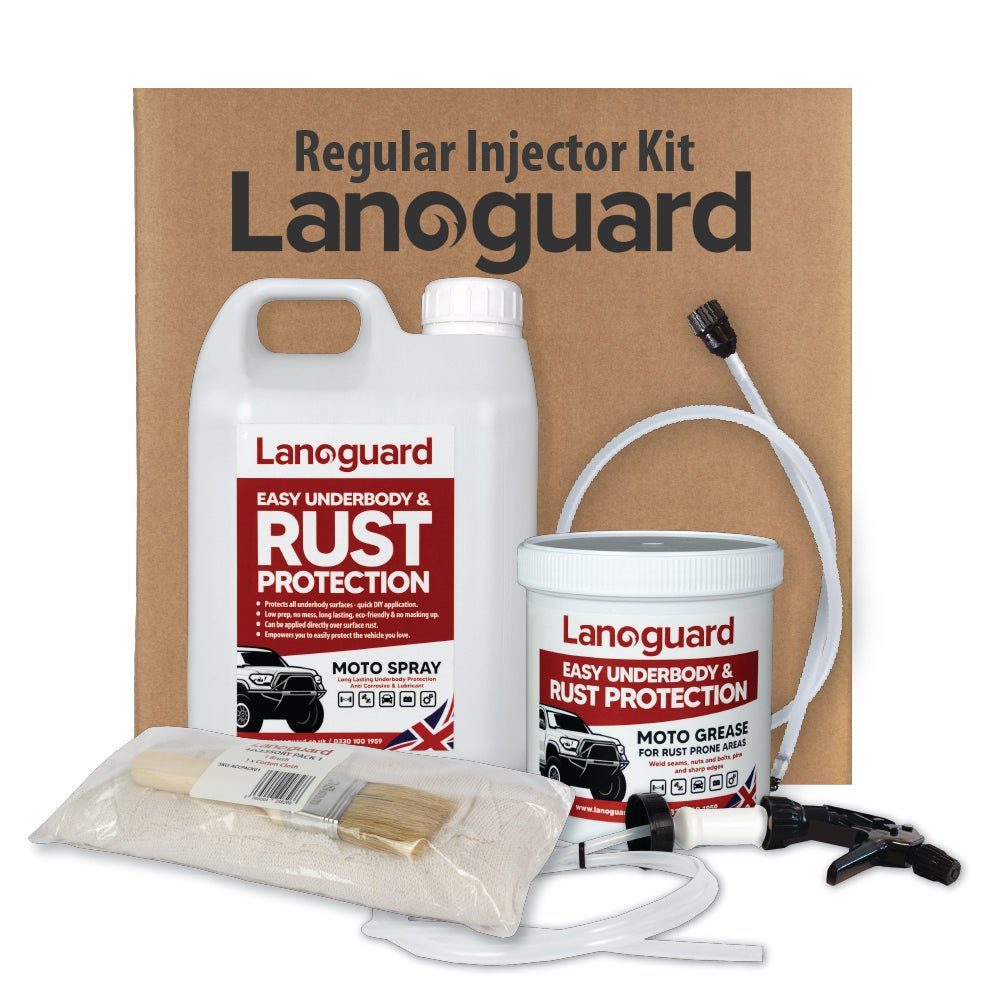

I have decided to get some Lanoguard for the chassis work, this kit to get in the nooks and crannies. I was going to get a 5l and make my own injector kit but why bother....i am getting old and lazy now hey.
www.lanoguard.co.uk
Lanoguard Underbody Rust Protection KitsRegular Injector Kit​
Our DIY underbody & chassis rust protection kit gives you everything you need for underbody protection for car & vans - QUICK & EASY. Click here for more info!
www.lanoguard.co.uk
www.lanoguard.co.uk
So wire brush to hand and a dust mass i guess and get cracking this week. once the front end is off.

I started to use ACF 50 on the boat aluminium window frames a few years ago and it helps them keep good. Not sure if to bother on these wheels yet.
